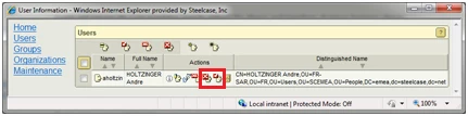

Remove the User from Windchill
1. Login to Windchill as an Organization Administrator.
2. Click Organization on the Major tab.
3. Click Utilities on the Minor tab.
4. Click the Principal Administrator link under the Business Administration heading.
5. Add the user to be removed to the Users table.
6. Click the Remove User From Cache icon in the Actions column for the user.
7. Click the Remove User From Windchill icon in the Actions column for the user.

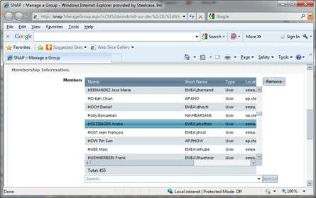

Remove the User from Active Directory Group
1. Login to snap in a browser.
2. Manage the windchill-usr-prod group.
3. Click the Update Group button.
4. Select the user in the Members table and click the Remove button.
[cid:image005.jpg@01CC7C4E.F4E89BC0]
5. Click the Submit button.
When a user leaves the company an automated email get's sent out to specific system administrators. The Windchill team have such administrators. Therefore we are able to remove that principal from the system which keeps our named users below our license count. We also use the License Auditing report to make sure that the number of named users is below our license count. If you would like to talk about this over the phone don't hesitate to give me a call.
