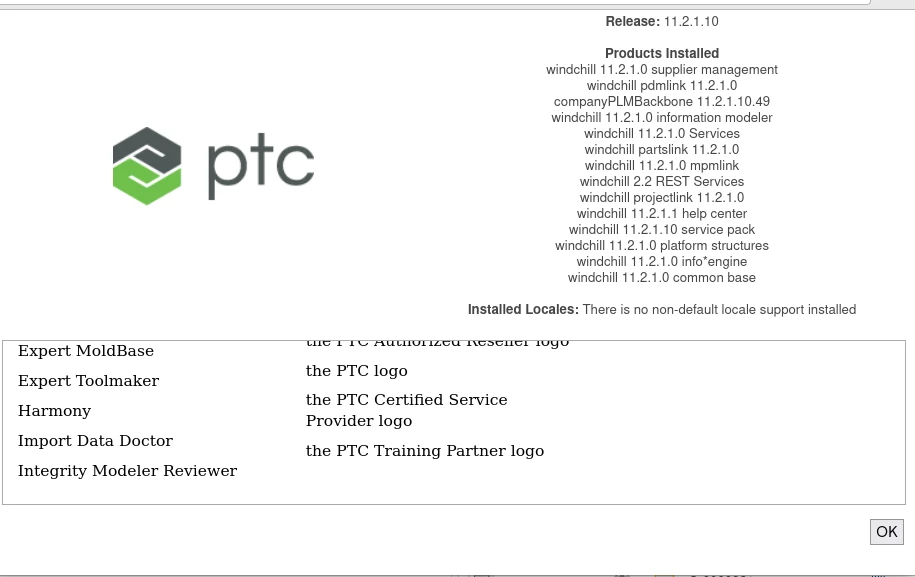

    i it is not installed i am working in local machine so how we can install it in local machine.
    i have these product installed:-softInstall.png
    avillanueva
    23-Emerald II
    Aug 10, 2023 1:14 PM UTC
    It is its own standalone installation. You can install it on the same server but many people put on a different host. Download the software but also note that it gets updated via service packs as well. Run the PSI from the service pack and you should see an option for a standalone installation for Solr.
    Once installed, you can configure Windchill to locate the index server via site.xconf properties.
    com.ptc.netmarkets.wp.ixb.index=index.html
    com.ptc.windchill.partslink.index.enabled=true
    wt.index.enabled=true
    wt.index.solrHost=<host of Index Server>
    wt.index.solrPort=8085
