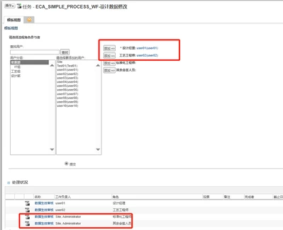

     I just I created a new progress,  and in one activity, This is how I set up participants
   and there are two more notification here,anyone know how to handle this problem?
   thank you so much!

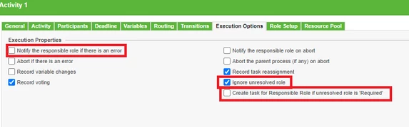

What the notification emails are saying?
If the role is not solved, there can be additional notification to admin that the role is empty.
You can handle this in the workflow task editor. what can happen if the role is empty
