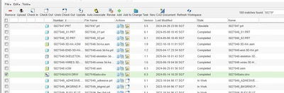

The status icons in the workspace no longer work
I am using Windchill PDMLink Release 12.0 and Datecode with CPS 12.0.0.4
There is no out-of-date prompt for the target component and drawing in the workspace, but an out-of-date prompt appears after opening the drawing
Translated text from Simplified Chinese to English using google translate

    Is this the message you are seeing? "WARNING: This drawing is more recent than the model"
    Sep 26, 2024 8:46 AM UTC
    Thanks for your help.
    Commonly, we can see the iron in integration view.
    But now it just appeared at Creo

    Sep 30, 2024 7:20 PM UTC
    If you customize the Workspace view, you can add the column for "Out of Date" objects. Then you should see a clock icon for the items in the Workspace that are not the latest iteration.
