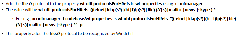

Hi all,
I've created a document structure.  For each object in that structure, I've attached a "New URL Link attachment".  The URL looks something like:
  • File://server_location/filename.htm
But, when I try to use the link (by clicking on it), the URL has a string (the string "unallowed") inserted.  In the web browser, it turns to:
  • unallowedFile://server_location/filename.htm
Is there any way to prevent the string “unallowed” from being inserted into the URL?
Graham
TomU23-Emerald IVAnswer
February 2, 2017
gedwards1-VisitorAuthor
February 2, 2017
Thank you so much!
I'll send this over to my Windchill admins to incorporate.
