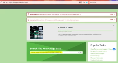

Take a look at this article
Attempting to delete the latest iteration or revision of an autoassociated Part fails with "[PART] could not be deleted/purged. There are objects associated to it through EPMBuildHistory link" in Windchill PDMLink
I found it by doing a search in the Technical Support Knowledge Base with the error you reported.
