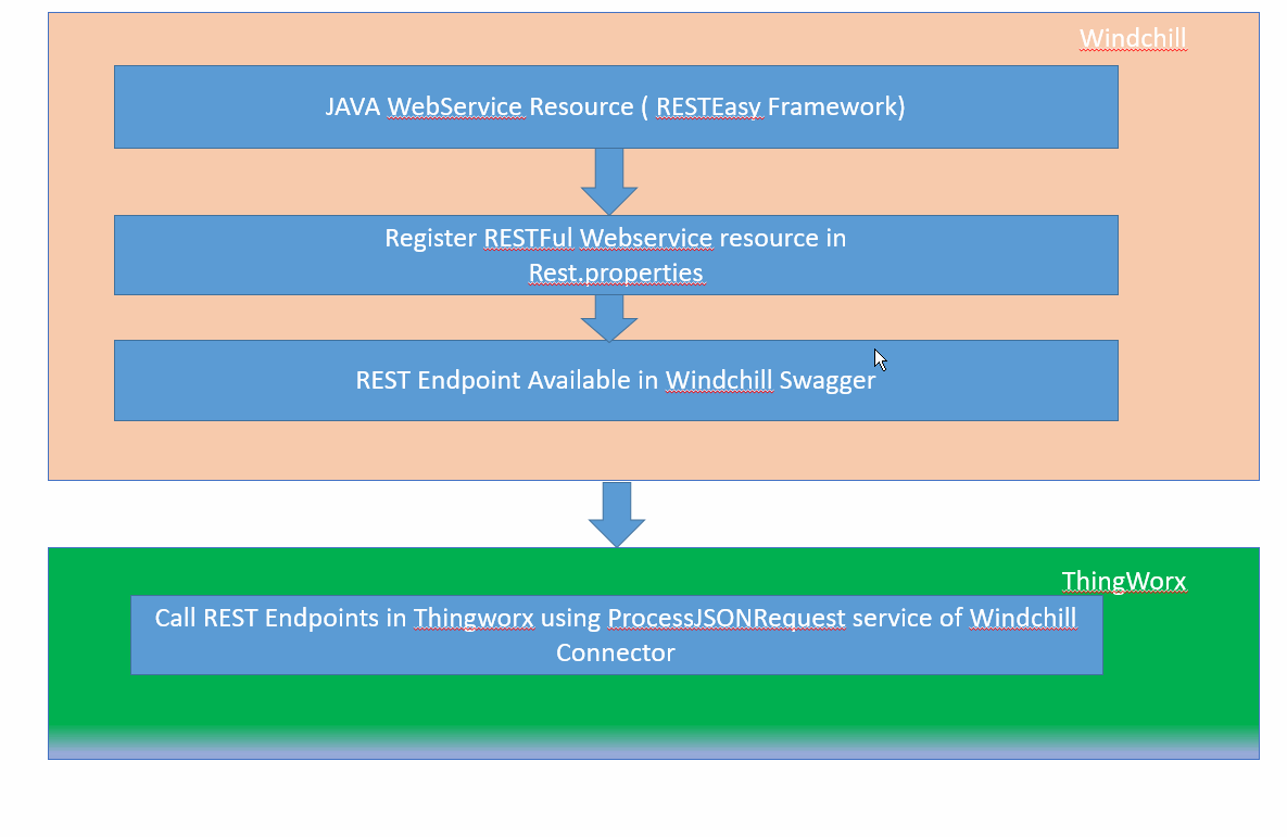

I am exploring Windchill extension on Thingworx. PTC has built out of the box functionality to access windchill data using infoengine. I did not find much on REST implementation.
Has anybody found a documentation on Windchill REST framework.

I developed custom POST and GET RESTful Web services in Windchill. There was a learning curve. I thought this overview might be helpful for the community. Please let me know what you think.
Preeti

Preeti,
REST services in Windchill are documented using Swagger. You can access the Swagger UI by doing the following:
1) Enable the site preference "Client Customization"
2) From Navigator, traverse to Customization > Documentation > REST APIs
Attached are some slides that provide information about Windchill REST services.

Hi Hemant,
thanks for the reply. I was thinking about emailing you. Glad that you replied. The PowerPoint is very helpful. I really like the architecture slide.
I am looking for an example which I can use to create my own Restful service which follows PTC Rest framework. It would be nice if something is available for the reference. It is hard work to look into each web service and trying to guess.

Hi Bjorn, MK and Saravanan,
Custom Restful service is supported for Windchill 11.0. I believe that there is patch which can be applied for prior versions. I will have to check. Please let me know what are your specific questions on custom REST services.
I have done quite a few Restful custom services for GET and POST.

I've opened few month ago a case to ask this question to the Support and that's the result:
https://support.ptc.com/appserver/cs/view/solution.jsp?n=CS183488
If you have other information then it would be really helpful. Thanks
