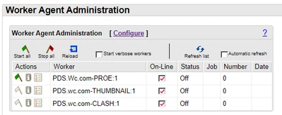

Hi Guys,
I started my CAD worker and it's working fine. I created same like this for Thumbnail Publish. But I didn't know how we can start this and which allowlist or whitelist to use for it.
Aj

Feb 14, 2024 11:03 AM UTC
More details:
Here ProE is a CAD worker
Thumbnail worker publishes PVS.
I run this comment to activate CAD worker. (Flag turned into Green)
<Property name="worker.exe.whitelist.prefixes" overridable="true"
targetFile="codebase/WEB-INF/conf/wvs.properties"
value="C:\ptc\WC_Workers\Creo|nohup /ptc/WC_Workers/Creo"/>
How we can do the same thing for Thumbnail Worker.
Aj

Whitelist setting applies for all workers I believe. You can create multiple acceptable paths but separating by a pipe character |. Looks like you are doing that already. Strange, looks like you have a windows and unix path listed.
https://support.ptc.com/help/wnc/r11.2.0.0/en/index.html#page/Windchill_Help_Center/WorkAgentSecurity.html
Feb 14, 2024 12:22 PM UTC
Thanks for the replay @avillanueva
After I added into Site.xconf, still thumbnail flag is executable not safe.
Aj
