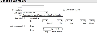

We recently changed our default thumbnail size - so I needed to regenerate thumbnails.
For this I did RegenerateLatestRepresentationThumbnails in WVS  Job Scheduler Adminstrator (at Site level).
That seemed to be working until I realized it was starting at the same place every day.  We have a scheduled backup that stops everything while it's backing up - that must be what is causing this?
Any suggestions?  Why is it regenerating the same thumbnails if it's only supposed to be doing latest?
It gets through about 8000, and I've got a LOT more than that.

Sorry for late reply. Still an issue or have you solved it.  Some questions. Is the task being completed properly? This should do a query (large) then start populating jobs in the publishing queue. Once the list is complete, this job should be finished and the system will burn those regeneration jobs to 0.  Did you set this job to be immediate and once or did you set a job frequency? If the latter, it will respawn every day on the schedule. You should be able to delete that job in the same UI as below. I think Latest is the latest iteration of the objects. What do you expect the total count to be? Look at your Master object count.

I've tried a few different things - and I've had no luck.  It appears to restart from the same point every day, i.e. it's doing the same files at the "beginning" of the list over and over.  I've tried both scheduled and immediate with the same result..
I THINK what's happening is that our server shuts down overnight to allow for a clean backup.  At that point when it comes back up - it re-starts that job at the beginning.  (this is speculation).
