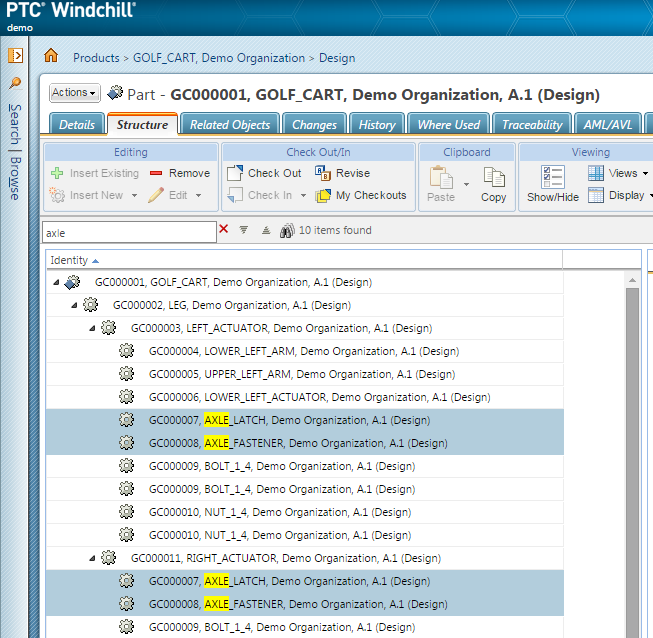

In the default Golf Cart Product, I want to create a context containing all parts including the word "AXLE" in the name.

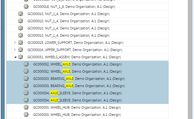

I know from a search that there are 10 Occurrences in the assembly, and want to create a context containing these parts and their parents up to the Golf Cart level.:

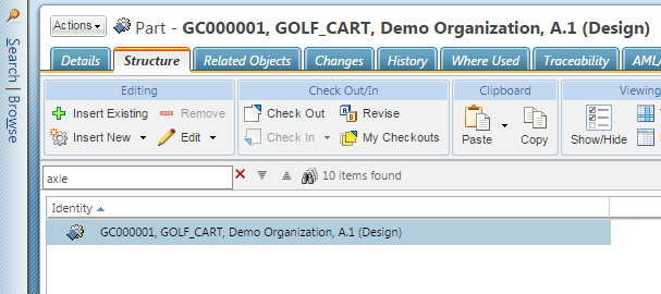

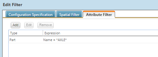

When I apply an attribute search looking for *AXLE* however, no results are returned.
Initial feedback suggests that the word AXLE would need to appear in the part name at every level above the areas I'm interested in, right up to the immediate children of the Golf Cart level, or for the filter to give the results we expected.  However, this does not seem to match how the user documentation explains that the the attribute filter works (unless it expects a completely flat tree structure).

you give the correct answer
The ConfigSpec (ie BOM Filter Criteria) , whatever is the type (default LATEST,lifecycle state,  effectivity, baseline, attributes etc ...) is resolved level by level. And stop the BOM explosion for each child that does not respect the config spec
You can combine and order diffreent type of criteria in your filter.   But in your case , as there's not really a common criteria on the axles parents ... don't think it is possible as is ....
Think you have to create your Design Context by exploding all the BOM and tick manually only the checkbox of the Axles parts to include in your context ...
