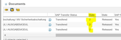

Hi Team,
I am able to create Traffic attribute and it is showing correctly on part information page but when i am using same attribute on customize table in a column it is only showing number (1,2,3) instead of graphical view. Please help to resolve it please find screen shots.

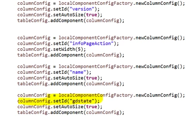

DataUtility is com.ptc.core.components.factory.dataUtilities.GraphicalAttributeDataUtility
defined in a components properties as
wt.services/svc/default/com.ptc.core.components.descriptor.DataUtility/graphicalAttribute/java.lang.Object/0=com.ptc.core.components.factory.dataUtilities.GraphicalAttributeDataUtility/duplicate
So use following dataUtilityID assign method
configRow.setDataUtilityId("graphicalAttribute");

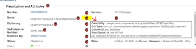

You might have neglected to call for the right data utility. When viewing the correct view on the part info page, add "&jcaDebug=true" to URL. You should see a bunch of lady bugs appear. Look at the one next to the traffic attribute and it should show the data utility. That needs to be called out in your table definition.
Feb 9, 2024 12:30 PM UTC
Hi
Thankyou for reply. That datautility is showing on multiple Lady Bugs. please see below two
Data Utility :com.ptc.core.components.factory.dataUtilities.NBSPDataUtility

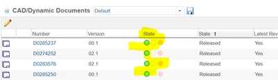

Feb 14, 2024 3:44 PM UTC
Thanks for reply.
I have created a table builder as below and configure the graphical attribute named "gdstate"
 here Graphical attribute "gdstate" is working correct with other ootb table but not working with custom table please see below screen shots.
working correct with below OOTB table
but with custom table its not working please see below
Could you please let me know how can i extends the data utility so it should work
