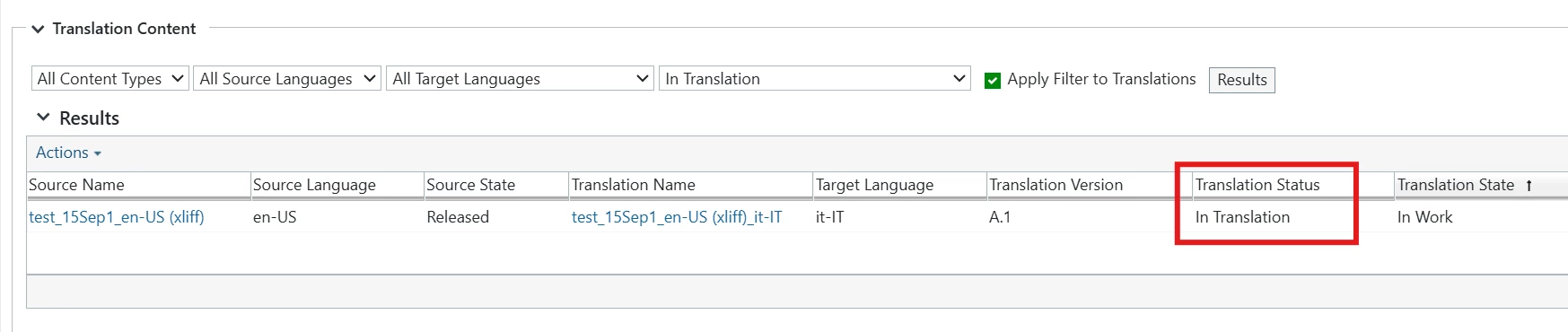

MarcoTosin
Sep 25, 2026 7:14 AM UTC
Could you clarify your request further?
Did you create the status you want to search for in your system, and do you want to create a report that retrieves the list of WTDocuments with that status?
Marco
6-Contributor
Sep 25, 2026 7:22 AM UTC
Hi ​@MarcoTosin , thanks for your prompt response, I'm trying to get consolidated report, which are in In-Translation status from all context level
MarcoTosin
Sep 25, 2026 8:13 AM UTC
I'd like some further clarification.
The image you shared is the result of a search performed in Windchill GUI, correct?
Are you trying to get a similar result using the query builder report ?
Marco
6-Contributor
Sep 25, 2026 8:17 AM UTC
Yes, I'm trying to get a similar result using the query builder report. with name, number, state and Translation status
