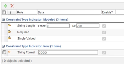

Hi Guys,
I am looking for a restriction on 'Reusable Attribute'.
1. For example, my attribute name is Test and its type is String.
2. Then i adding in WT Part, there we have a option Constraint. Right
3. Rule which i want only 3 digits required that mean i can use String Length, but i want only numberic not alphabet which constraint we can use on here.
Aj

Hi @Amirtharaj_K
You can use String format
DDD like decimal decimal decimal

Thanks for the Replay @HelesicPetr
Can you give me more details about String Format and also other types.

Hi @Amirtharaj_K
Check the help.
Attribute Constraint Rules
PTC recommends to user regular expression instead but if it works it is the easiest way how to add a format constraint.
