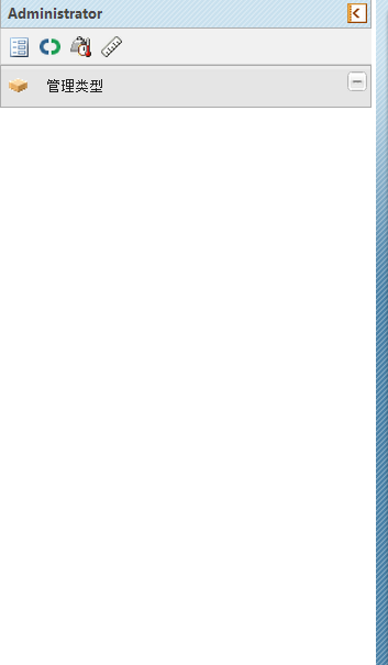

type management can't display
I deleted some datas from the database table  "wttypedefinitionmaster" ,"wttypedefinition", and then type management can not be displayed, method server report these errors. Then I flash back the datas, but it's also not work.Can you help deal with it, thank you!

2-Explorer
Apr 14, 2016 2:51 AM UTC
Try clearing the cache once. But I think there are some missing references in some tables. If you have a full backup of database, restoring it is the best option.
è吕1-VisitorAuthor
Apr 14, 2016 6:16 AM UTC
First of all,Thank you for your reply.
I have flashed back the data,but it seems to be ineffective. I'm not sure where's the problem now .....
