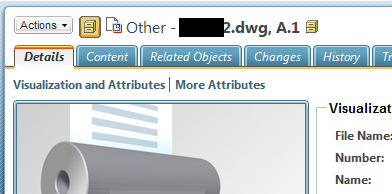

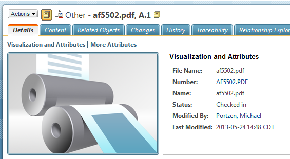

Once in a while I have a user that will check in a file from a workspace they didn't mean to and didn't realize they did.  These files go in a the type "Other".  I thought I could just create a policy that won't allow anyone to check in a file of this type.  When I went to the Policy Administration I couldn't find it.  Is this possible?

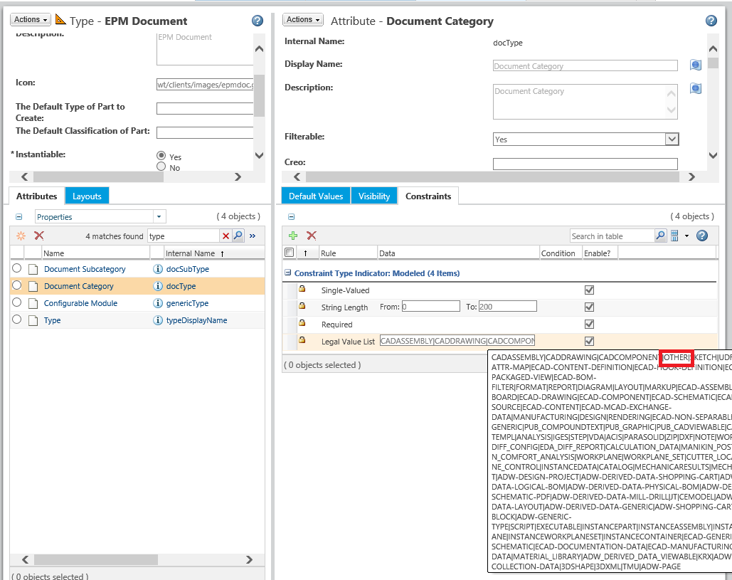

I don't have a solution ready, but for your information, Other is not a Type. You won't find a Type "Other" in the Attribute and Type Manager. So you won't find it in the Policy Manager. This is a normal EPMDocument with the Attribute "Document Category" set to Other. The icon is dependent with this attribute.

How can I prevent someone from checking in a file where the category is "Other"?  Or is that not possible?

When these files are imported into the WS, they show as "CAD Document" in the WS [when mousing over the object type indicator icon], and once checked into the CS, they show as simply "Other".  In both cases the icon is the same as you have shown.  If I show the information page for the object in the WS, it shows as "Other". If I recall correctly, in previous versions of Pro/Intralink (pre 10.2), the objects showed as "CAD Document Other" in the WS and CS, but I cannot confirm this.

The "Other" is the "Document Category" attribute value of EPMDocument
