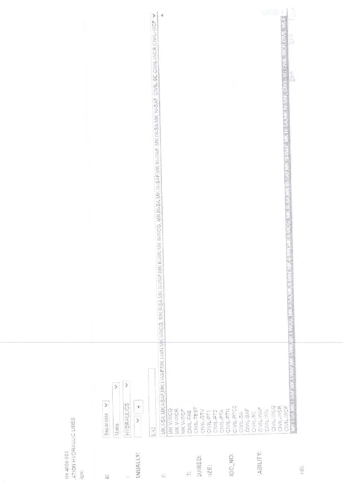

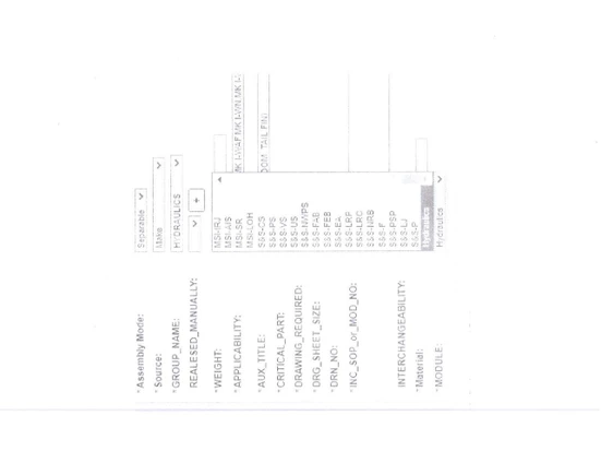

Nandha7-BedrockAuthor
7-Bedrock
Feb 9, 2024 9:44 AM UTC
Hi
Type - part.
Attributes - XXXX (Example - Material), data type - String
Constrains - Legalvalue
Image for your reference.
HelesicPetr
Feb 9, 2024 9:58 AM UTC
Hi @Nandha
You need to check the type and attribute management definition of the enumerated list
There can be some wrong definition.
PetrH
Feb 9, 2024 4:09 PM UTC
Hi
Can you check and correct type and attribute in subtype (document or part type) in organization or site utility with admin credential ,
check weather may be the attribute legal value or enumerate value then correct spacer ( | ) in between value
otherwise connect with me i help further
Thank
