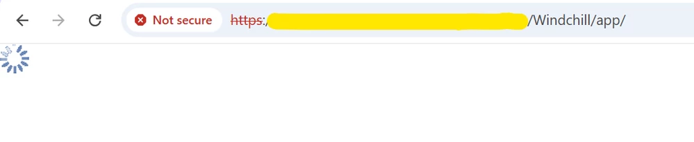

Unable to access windchill due to Solr server error
When login to windchill UI, page keeps loading and getting Solr server error in Method server logs.
Method Server Logs:
2025-05-20 18:24:37,751 ERROR [pool-5-thread-1] wt.index.StandardIndexPolicyManager  - Exception while pinging the index server org.apache.solr.client.solrj.impl.BaseHttpSolrClient$RemoteSolrException: Error from server at http://xxxxxxxxxxxxxxxxxx.com:8085/solr/wblib/admin/ping?wt=javabin&version=2: Expected mime type in [application/vnd.apache.solr.javabin, application/octet-stream] but got text/html. <html>

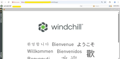

The two (or three) are unrelated.
Your SSL certificate error is tied to your SSL certs in the Java keystore (jssecacerts) and Apache.
The hamster wheel can be something entirely separate.
Windchill will start and be usable even if SOLR is inaccessible.
7-Bedrock
May 20, 2025 4:17 PM UTC
SSL Certificate is not the issue. I can still access another similar Windchill server.
