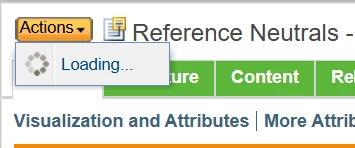

Hi Team,
Need some help from the community.
Unable to see the Actions list when click on Actions for the WTDocument in Infopage.
When select the WTDocument in folders page and click on Actions it does show all the list.
Any idea wht could be the probable causes.
Thanks in advance.

Aug 22, 2025 4:33 AM UTC
Hi Thanks for reply.
Digging further found the cause.
There was a issue with one of the tag in customactions.xml
After fixing this things are working fine.

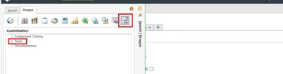

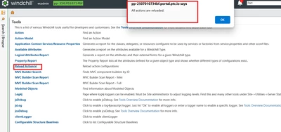

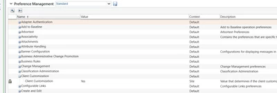

Enable client customization and reload action :
1- Site > Utilities> Preference Management> Client customization :
2- client customization > tools > reload actions :
