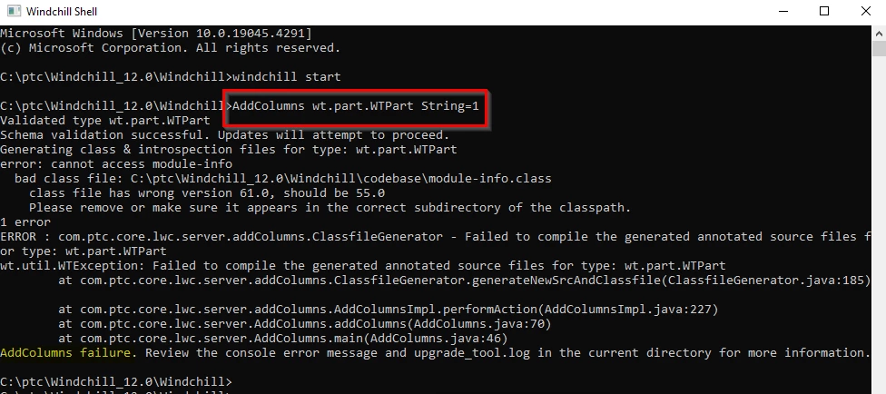

Hi All,
Can you help me unable to create local attribute and i did excuted belows commands for windchill shell  but  columns are not creating
the commands
AddColumns wt.part.WTPart  -f String=2
AddColumns wt.part.WTPart String=1
Following error i got
C:\ptc\Windchill_12.0\Windchill>windchill start
C:\ptc\Windchill_12.0\Windchill>AddColumns wt.part.WTPart String=1
Validated type wt.part.WTPart
Schema validation successful. Updates will attempt to proceed.
Generating class & introspection files for type: wt.part.WTPart
error: cannot access module-info
bad class file: C:\ptc\Windchill_12.0\Windchill\codebase\module-info.class
class file has wrong version 61.0, should be 55.0
Please remove or make sure it appears in the correct subdirectory of the classpath.
1 error
ERROR : com.ptc.core.lwc.server.addColumns.ClassfileGenerator - Failed to compile the generated annotated source files for type: wt.part.WTPart
wt.util.WTException: Failed to compile the generated annotated source files for type: wt.part.WTPart
at com.ptc.core.lwc.server.addColumns.ClassfileGenerator.generateNewSrcAndClassfile(ClassfileGenerator.java:185)
at com.ptc.core.lwc.server.addColumns.AddColumnsImpl.performAction(AddColumnsImpl.java:227)
at com.ptc.core.lwc.server.AddColumns.addColumns(AddColumns.java:70)
at com.ptc.core.lwc.server.AddColumns.main(AddColumns.java:46)
AddColumns failure. Review the console error message and upgrade_tool.log in the current directory for more information.

Hi @Sarathkumar_M
It seams that you use wrong version of java.
Try this>
https://www.ptc.com/en/support/article/CS366519
PetrH
