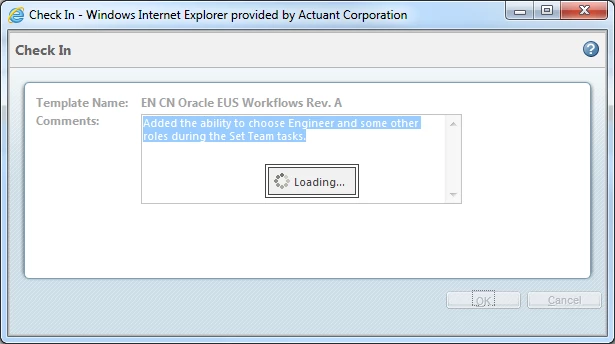

I have been in Workflow Template Administrator today. I was able to edit a workflow template, save it, and close it. However, when I attempt to check it in, the browser just hangs (1st screenshot below).
IE9. Windchill 10.2 M020. Java 7-51.

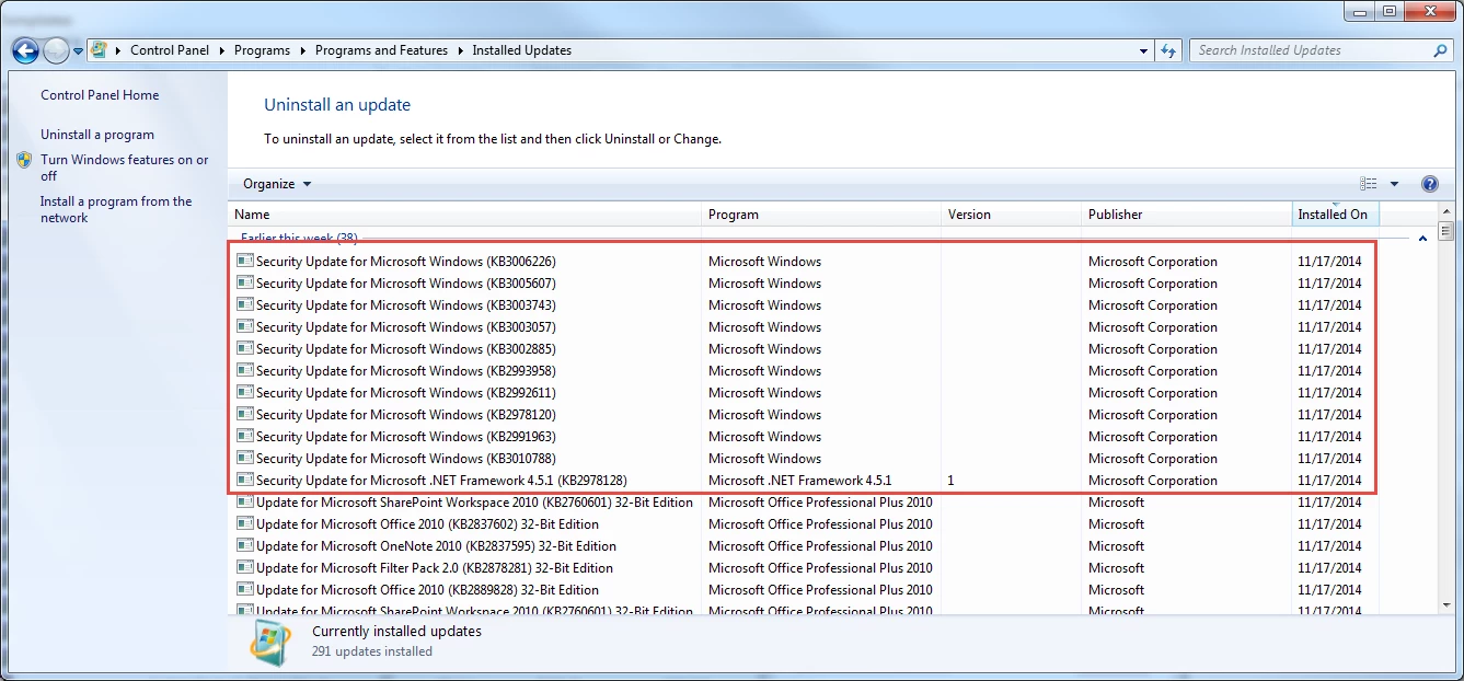

I flipped over to Firefox and Chrome, and I was able to check in the workflow template. I uninstalled these MS updates (2nd screenshot) and then I was able to check in the workflow template with IE9 again.

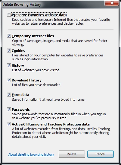

I ran into the same problem after those updates were installed. We are running IE9, JRE7u51, Windchill 10.1 M030. I found that after the installation of the patches, IE wants the JRE updated. Our IT department is working on a fix, but if you close all browsers and delete everything below the folder C:\Users\<userid>\AppData\Local\Microsoft\Internet Explorer and restart IE, it all works again, with the patches installed.

Thanks for the help. I just deleted all of the history through the UI. It accomplished the same thing.
At first, I only deleted the temporary internet files. But that didn't work. So instead of messing around, I just deleted it all.
Thanks again for your help!
