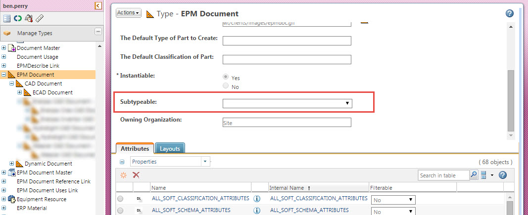

Thanikachalamurthi Aruchamy‌,
This might be stating the obvious, but did you check the setting "Subtypeable" in Type/Attribute Manager?
taruchamy12-AmethystAuthor
Jan 27, 2016 7:33 AM UTC
Hi Ben,
Thanks.
I did not check “SubTypeable” earlier. Howevwe, after enabling the same, the issue still persists.
Regards
ShirishMorkhade
Jan 28, 2016 2:20 PM UTC
Hi Thanikachalamurthi,
This is intended behavior. Even I tried it with subtypable to true on older releases (10.0 and 10.1) and got same behavior.
EPMDocument cannot be subtyped and "wt.epm.EPMDocument cannot have more than one type" error message is expected while creating of Soft-Type for EPMDocument in Type and Attribute Manager.
