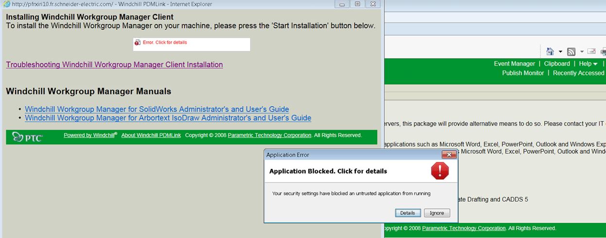

Hello All
I am having some issue in installing Windchill work group Manger from Windchill 9.1 WGM.JPG
I had java 8 , I remove and installed java 6 and 7 but again failed
Later I added under the exception site list in java , But Again failed
Anyone come across with this error while installing ?
Best Regards
June 15, 2017
Hi Gagan,
Please re-verify, if you have added the exception site list as mentioned in Article CS157211.
If still issue exists, use "Troubleshooting Windchill Workgroup Manager Client Installation". Refer article CS33195
