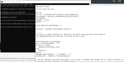

Confused a bit but it seems that setup.vbs just opened in Notepad for edit? Sounds like a filetype association. This appears to be your issue:
https://www.winhelponline.com/blog/vbscript-files-open-with-notepad/

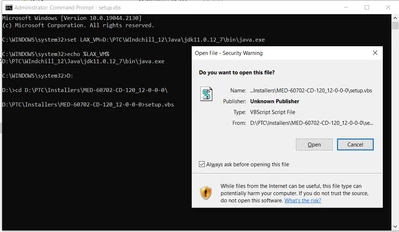

Nov 20, 2022 1:43 PM UTC
Thanks for your inputs  MikeLockwood & avillanueva.
Please find snap for your reference . Still I m struggling to launch PSI.

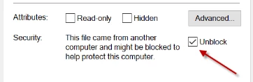

One other thought comes to mind.
Sometimes (I don't know what triggers), you have to "unblock" the zip file downloaded from PTC before extracting it.  I routinely see if they are blocked now.
