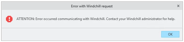

Unable to Open Creo View when Windchill is using HTTPS
I'm running into an issue with Creo View when Windchill is configured to use HTTPS.  Attempting to open anything from Windchill in Creo View throws this error:

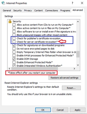

  • Following the steps in CS312299 to alter Edge internet properties to not check for certificate revocation will allow the Creo View login dialog to appear, but as soon as credentials are entered the dialog closes and Creo View never appears.  (Webserver logs do show successful authentication.)

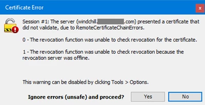

I installed Fiddler and enabled HTTPS decoding.  Attempting to open a representation from Windchill threw this (Fiddler) error message:
This system is on an isolated network that does not have internet access.
The message about checking for certificate revocation seems to point back to CS312299.  I repeated the steps in that article again, and this time I noticed the comment about the second one not taking affect until restarting the computer.  (The PTC article does not mention needing to restart.)
After a restart Creo View will now launch successfully, but the pview.exe process(es) will not terminate after closing.  End users (who make this same change) can see objects in Creo View, but from the servers Creo View just displays a blank white page.  The mouse seems to act like there are lines present, but none of them are visible or selectable.  Just for fun I downloaded a representation and opened it locally in Creo View on the server (without Windchill) and still get the same behavior, so apparently the 'not displaying geometry' issue in Creo View is unrelated to HTTPS.  Any suggestions on that?

Info 5:43:12.544 15 Mar 2024 2680 10496 internet DownloadTask HttpSendRequest failed, error: 12057 -
HTTP Error 12057 indicates an inability to validate the SSL certificate's revocation because the revocation server is unavailable. Disabling certificate revocation resolved the issue, suggesting a need for correction.
For further troubleshooting, we installed Fiddler to determine what exactly Creo View was attempting to access. We discovered that at the error step, it was trying to download a CRL file. CRL stands for Certificate Revocation List. While it could download the CRL, it failed to validate the revocation, resulting in an error.
At this juncture, I am consulting with both my internal IT and PTC to identify the issue with the CRL. PTC responded that the IT team needs to address the revocation issue, and our internal IT is uncertain about the necessary certificate changes. Further analysis by the internal IT team revealed that the Delta CRL was not properly configured, leading to the problems. Once they rectified this, Creo View began functioning correctly. As these are internally self-signed certificates, we experienced configuration issues, whereas third-party certificates should be properly configured.
