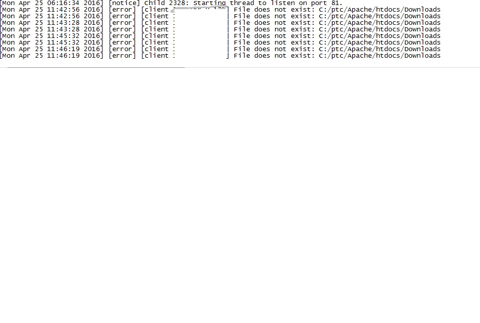

Hi all,
I'm trying to integrate Creo 3.0 M080 and Auto CAD 2016 with Windchill PDM Essentials 10.2 M030 (CPS13) but getting error " Invalid server location".
We've Windchill url like abc.xyz.com:81/Windchill. We're using port 81 for web server.
We're able to access windchill through browser with out any problem but  unable to do CAD integration.
I'd like to mention that we're not using VPN to access Windchill server and default browser for Creo is IE.
Kindly help me out.
Krishna Chaithanya.

Try clearing all the browser and Creo caches. Also go through Apache error log and MS log, there should be some additional information on this.

Hi Binesh,
Thanks for your reply. I'd cleared all browser caches. But, still  facing the same problem.
I've gone through Apache error log, there I found below errors..
Krishna Chaithanya

Hi Krishna,
There is something wrong in the webserver configuration unless you see anything wrong in the method server logs. See this https://support.ptc.com/appserver/cs/view/solution.jsp?n=CS22127
