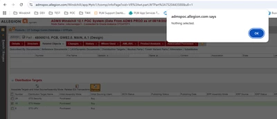

Unable to Remove Distribution Target from WTPart
or when I select 'ALL'
RG-AlleAnswer

missed
tableConfig.setSelectable(true); in our custom code, once I added it, it is working

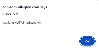

Dec 24, 2025 10:43 AM UTC
Please share the related MethodServer logs for more details about the issue.
RG-Alle12-AmethystAuthor
Dec 24, 2025 2:16 PM UTC
2025-12-24 09:15:20,530 ERROR [ajp-nio-127.0.0.1-8010-exec-176] com.ptc.jca.mvc.controllers.ActionController abcuser - java.lang.reflect.InvocationTargetException java.lang.reflect.InvocationTargetException

Caused by: java.lang.NullPointerException
	at com.ptc.windchill.esi.svc.ESIServicesCommand.removeTargetAssociation(ESIServicesCommand.java:143)
	... 67 more

Dec 24, 2025 4:44 PM UTC
enable logger com.ptc.windchill.esi.svc.ESIServicesCommand  to DEBUG , reproduce the issue and share stacktrace
