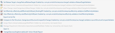

Use Case: Unable to see Mass Change Icon on the resulting objects table of a Change Notice.
Description:

PTC confirmed the action is on the Details page and not on edit page anymore.

Enable logger com.ptc.windchill.enterprise.massChange.validators.MassChangeActionValidator
Reproduce the use case and share MS log

I am unable to click on the action itself. It says Hidden. How can i enable it ?

@Fadel suggestion will show the logs from that validator that is hiding the action. It should have a reason why.
