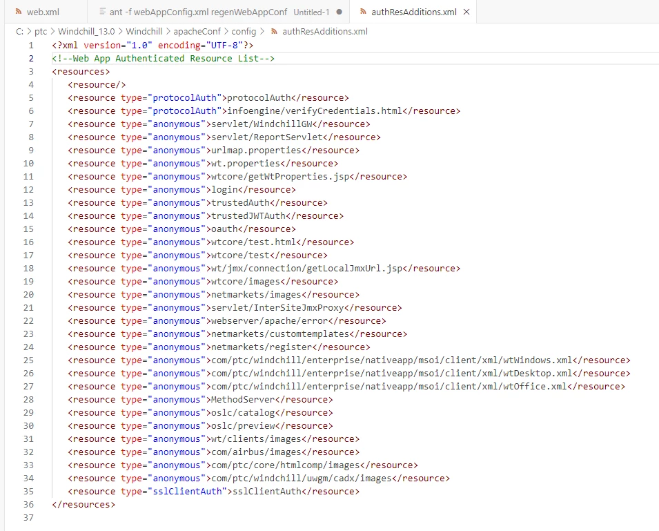

First of all, when following the help center instructions, we couldn't found the resource without attribute in
<Windchill>/apacheConf/config/authResAdditions.xml file.

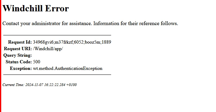

3- The application url context does not redirect to the new form, it shows the following error:
ERROR : org.apache.catalina.core.ContainerBase.[Catalina].[localhost].[/Windchill].[MVCDispatcher] - Servlet.service() for servlet [MVCDispatcher] in context with path [/Windchill] threw exception [wt.method.AuthenticationException] with root cause wt.method.AuthenticationException
 at wt.session.SessionAuthenticator.reauthenticateUser(SessionAuthenticator.java:251)
 at wt.session.SessionAuthenticator.getUserName(SessionAuthenticator.java:157)
 at wt.auth.AuthenticationServer.getUserName(AuthenticationServer.java:170)
 at wt.session.StandardSessionManager.getAuthenticationName(StandardSessionManager.java:500)
 at wt.session.StandardSessionManager.getPrincipal(StandardSessionManager.java:165)

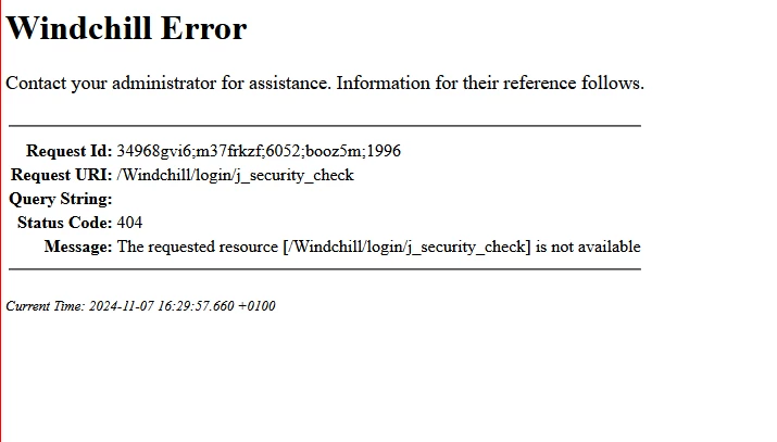

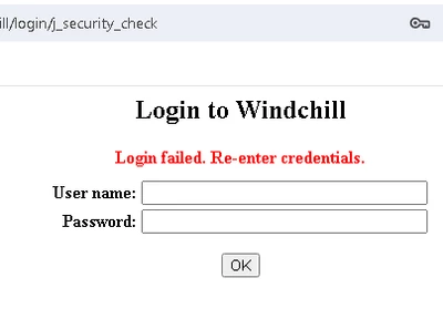

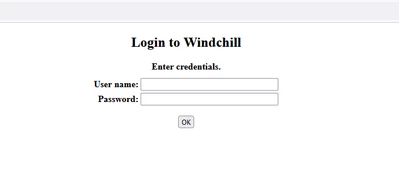

The form is only displayed when requesting explicitly its URL: http://hostname/Windchill/login/login.jsp
 But after put the wcadmin credentials, it shows the following error:

First of all, there is an ant command that execute all the configuration of FBA in a Windchill OOTB environment (to be executed in <tomcat>/configAuth :
ant -f authConfig.xml enable
This command update windchill properties and tomcat for a basic FBA.
In our case we detected that the realm was not well configured by this command and I added it manually in the tomcat server.xml and server.xml.default files.
After, it worked.

The goal is to configured the FBA in a standard Windchill PDMLink and it seems that we were unable to configure correctly the j_security_check mecanisum as in the topic you noticed.
After following the PTC documentation error page is always displayed (with HTTP code 200) and no logs from TOMCAT are generated:
It seems that we missed a configuration.
