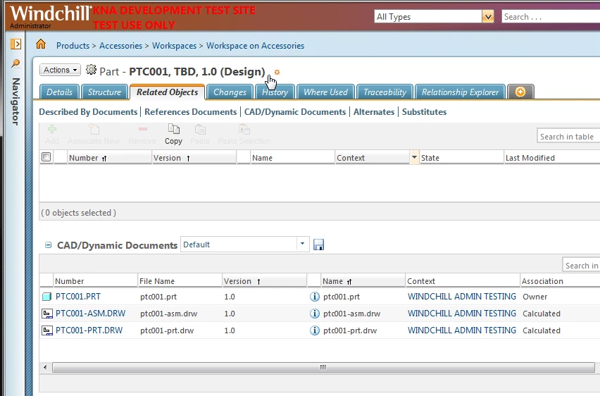

SO, these calculated links to drawings are cause us trouble.
Have any of you found a way around these issues?
It appears that any drawing the Owner EPM doc is related by 'Drawings Reference' to gets added as a calculated link to its WTPart, and you cannot remove this link.
I set the preference Operations-AutoAssociate- Create Content Links for Drawings to Yes, this had no effect.
This causes us these problems.
1. 'temporary what-if' drawings are added
2. Collectors in Revise, Move, Promote, Affected objects, etc. collect these Undesired calculated linked objects
a. Users then must be very diligent
3. Wt.Maturity.getPromotionSeeds also collects these objects, so my transitional check of Checked out Promotion Objects has an exception if a Calculated linked object is checked out, even though it is not a promotable.

Vaughn,
Calculated is not a modeled link in the database. The association is
derived based on other relations. So, Windchill does not allow you to
delete "calculated" association between CAD Drawing and a WTPart.
Check the following link, if you want to set "content" as default

I'm looking for the same thing.  Disable "Calculated" links so that the system stops creating them on it's own.
GregoryPERASSO
Oct 24, 2017 1:25 PM UTC
Hi
have a look here
https://www.ptc.com/en/support/article?n=CS11410&language=en&posno=2&q=calculated%20link&source=search
Set the following site preference in <Windchill>\codebase\wt.properties in Windchill Solutions 9.0 M080 or later and 9.1 M070 or later to hide calculated link types from Windchill user interfaces:
​wt.epm.displayCalculatedLink=false
Values: false, true (default)
Description: configure whether Calculated Association Link type between Drawing and WTPart will be not be displayed.
- True - Calculated Association Link type will be displayed between Drawing and WTPart.
- False - Calculated Association Link type will NOT be displayed between Drawing and WTPart.
