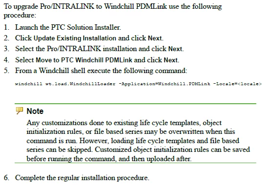

I am quite new to Windchill Administration and now and I am faced with a big task. For my client, I have to update Intralink 11.1 to Windchill PDMLink 11.1. I found a quick guide here but it is not clear to me.
What are the steps of this update? I know I have to make all backups like for a regular system upgrade and then I should run PSI and select Update Existing Installation.
If someone has the experience and can help me with this update it will be a huge help.

I've never done this conversion, but based on the documentation it sounds like you just re-run the installer.
https://www.ptc.com/support/-/media/support/refdocs/Windchill_PDMLink/11,-d-,1/WCInstallConfigGuide_173750.pdf?sc_lang=en
(page 70)

MattPat14-AlexandriteAuthor
Oct 15, 2020 2:12 PM UTC
Thank you so much. Do you think that after a successful installation it will be working as previous I mean there will be the same users, files etc?
TomU
Oct 15, 2020 2:27 PM UTC
I would think so.  As long as you backup the database and the Windchill directory on the server, it should be simple enough to roll back to the pre-upgrade configuration if you don't like something or it didn't work the way you hoped.

Note: Intralink 7.x and beyond are actually the full Windchill PDMLink installation with many things disabled.  The "migration" is mostly just enabling many of those things.
The database and Windchill DS remain essentially the same, so all users, CAD and other data, states, history, published viewables, etc., etc. remain.
