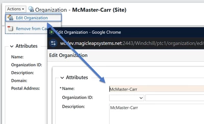

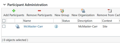

joe_morton
Aug 21, 2025 1:57 PM UTC
I'm sorry I am unable to meet with you. But here are some more specifics to help:
  • We are using the SUMA module (I think you are too). As an example, we have the Supplier McMaster-Carr in Windchill.
  • Here in the Participants Administrator, I searched for McMaster-Carr and I found the Site that got created when the Supplier was created
  • Click on the Site to open it's info. From there, you can click Actions -> Edit Organization
  • The Site's name is editable here. Changing this updates the Supplier name as well.
  • All the parts associated with that Supplier will show the updated name
