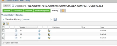

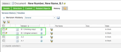

Jan 16, 2024 2:38 PM UTC
There is nothing wrong with the query and it gets the expected outcome, documents remains editable :
  • update WTDocumentMaster set WTDocumentNumber = 'New Number', Name='New Name' where WTDocumentNumber= 'WEX2069147649';
You might need to check with the admin if such change is allowed in your instance, not violating some business rule.
Also providing the persistence error you get can help clarify where the issue is.
the more details you can give, helps you get accurate/faster answers.
