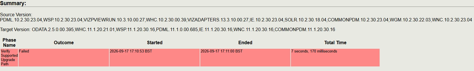

I am using Windchill PDMLink Release 11.1 and Datecode with CPS F000 Migration process fails at Verify Supported Upgrade Path, acording to PTC that because there are different disk installations, but I can't match the install disks Source Version: PDML.10.2.30.23.04,WSP.10.2.30.23.04,VIZPVIEWRUN.10.3.10.00.27,WHC.10.2.30.00.39,VIZADAPTERS.13.3.10.00.27,IE.10.2.30.23.04,SOLR.10.2.30.18.04,COMMONPDM.10.2.30.23.04,WGM.10.2.30.22.03,WNC.10.2.30.23.04 Target Version: ODATA.2.5.0.00.395,WHC.11.1.20.21.01,WSP.11.1.20.30.16,PDML.11.1.0.00.685,IE.11.1.20.30.16,WNC.11.1.20.30.16,COMMONPDM.11.1.20.30.16

your question is not clear. can you provide a screen grab of the error? if you are trying to understand the disk then open the version.xml file and look at line 2
Sep 18, 2026 8:25 AM UTC
Good morning, right now, there are some diferences between the Source Version and Target Version, and its always being said to me that the target version should have the same installation disks. My problem is that I’m installing disks that aren’t showing on the target, for example solr, that I installed yesterday and it still doesn’t show
Sep 29, 2026 9:33 PM UTC
Solr is not necessary for the upgrade. If you log a call with ptc they will show you how to modify a file (i cant remember which one) so that the two match
