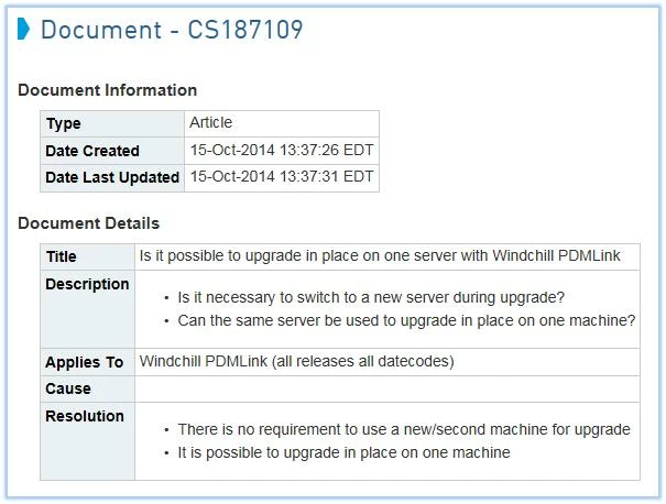

October 16, 2014
This just came through from PTC today. FWIW.
Title
Is it possible to upgrade in place on one server with Windchill PDMLink
Description
* Is it necessary to switch to a new server during upgrade?
* Can the same server be used to upgrade in place on one machine?
Applies To
Windchill PDMLink (all releases all datecodes)
Cause
Resolution
* There is no requirement to use a new/second machine for upgrade
* It is possible to upgrade in place on one machine
[cid:image003.jpg@01CFE94A.F3BE9940]
October 17, 2014
Jason’s comments and the article (CS187109) are technically correct. What it really means is the upgrade process is much, much, much better than it used to be and we aren’t required to have three sets of hardware like we were told in the Windchill 8.0/9.0 time frame. We still need two sets of hardware (test and production).
Maybe Windchill migration, upgrade and update experience has made me overly risk adverse but I would not recommend upgrading production directly. I prefer to upgrade in the test environment and rehost it to production when successful.
