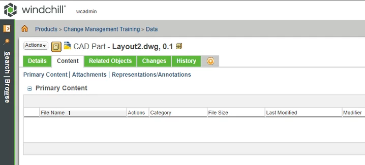

Hi
I trying to add the primary content to a emp document that i created using the api rest service
There is a method in the API rest service to do this?
Thanks in advance
October 25, 2022
@NC_10068031.. There is not rest endpoint to add primary content to CAD.
Using API.. Try checkout CAD to workspace, add content, checkin. Refer following article.
https://www.ptc.com/en/support/article/cs348427
Note: Please note that use of such constructors are a bit risky. Please do not create EPMDocuments in this manner unless you know exactly what data is  required by the application, as incorrect usage can result in data corruptions

December 2, 2022
Are you going to relate the file to a WTPart, or manage it in the future using Windchill Workgroup Manager? If no to both, you could consider storing DWG files in a regular Document. You could still get a number and revision control - but no BOM structure. I'm not familiar with the rest API, so I don't know if that's any easier.
