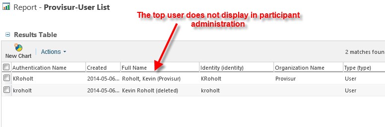

We have a temporary user who is no longer with the company.  The user is in Windchill twice.  Once as a user who is 'deleted' and the other record is still active.  When we use Windchill's participant administration the KRoholt user does not appear in the list.
When we attempt to do an advanced search in WC 10.1 and chose 'created by' in advanced search, only the kroholt (deleted) account appears in the list to select.  This is preventing us from search for CAD objects that were created by KRholot.

Sep 25, 2015 3:01 PM UTC
After more investigation, our network administrator had removed the account from active directory.  For a test, I had the KRoholt AD account re-created.  Once that was done, the KRoholt came up in all the search list and we are now able to search for the objects this user created.

Another approach you can take is to delete the account from Active Directory and then manually recreate it in your Windchill Directory Server.  The user will show up as disconnected and you can simply remap them to the newly created Windchill DS account.

The report does't look good, you have two different users with the same user id(differing in case). Since both of them did not appear in the participant's list before, I would assume they are either disconnected or disabled.
I am curious to know what the output of the report would be now?  If you can run a query like below, that would give some more information.

Sep 25, 2015 6:42 PM UTC
The report looks the same after adding KRoholt back into AD.  Clarification, the kroholt marked as 'deleted' did show up in our user list.  It was only the top entry that did not show.
Here is the result from running the sql query you provided.
