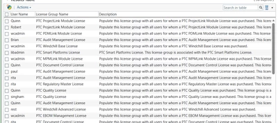

User assigned license & last login report
Using the attached QML, I was able to retrieve the users assigned to their respective licenses. However, the report is also returning the associated team roles along with the license or group names to which the licenses are mapped.
Do you have any suggestions on how to exclude all team roles from the report? Although the criteria section technically allows filtering out roles, it is not practical to identify every possible role and create separate criteria entries for each one.

try this ,I used a dummy trick , all license groups starts with PTC:

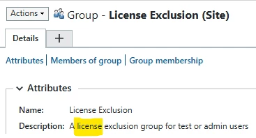

FYI: To include all PTC license groups, including those not beginning with PTC (e.g. License Exclusion and Platform Structures), filter groups where their description includes the word 'license'.

license exclusion is not a license group ,and  its intended to be used only for admins to test actions.

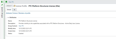

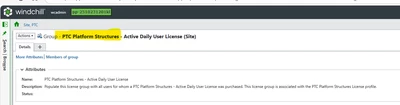

the "platform structure" that you mean  is also not a license one , the license platform license one has well  PTC in its name :
