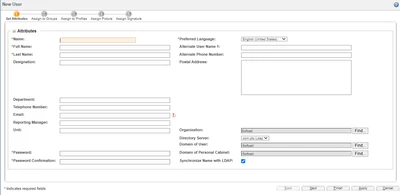

Hi Guys,
I have a few changes to User creation like the below image adding the new attributes, but the alternative user does not work. Whatever I entered didn't save in attributes.
Thanks in Advance,
Amir

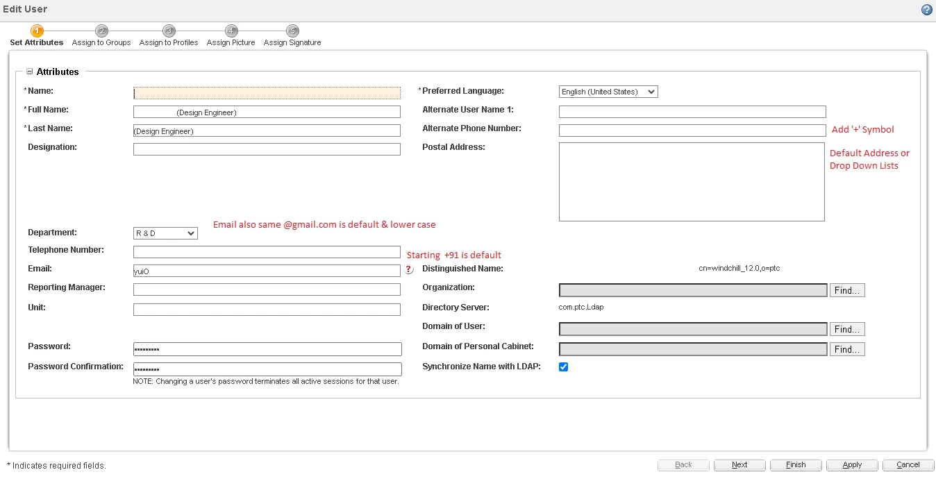

Oct 30, 2023 12:22 PM UTC
Hi @Amirtharaj_K
Check create and edit layout in the type and attribute management.
Is the following picture more clear?
PetrH

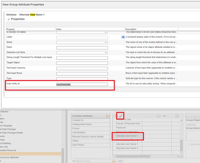

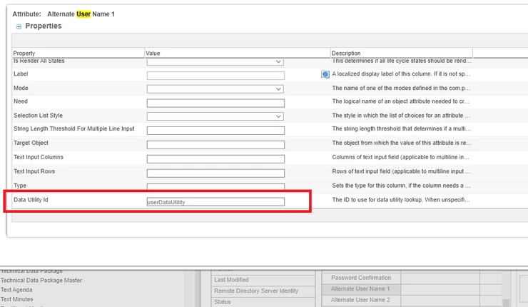

HelesicPetr
Oct 30, 2023 11:58 AM UTC
Hi @Amirtharaj_K
Check if the Alternate user name has a datautility defined - userDataUtility
If you remove the attribute from the UI then you need to redefine the DAtAUTILITY when you add the attribute back to grid UI

Oct 30, 2023 12:05 PM UTC
Hi Mr. Petr, Thank for the replayed.
I didn't know where i can get the "Data Utility ID", can you brief more on that.
Once again Thanks so much for your supporting me, I learned lot of thing from you.
Amir
HelesicPetr
Hi @Amirtharaj_K
