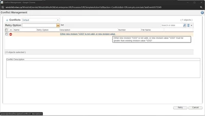

User is unable to change version of a part from V202 to V203.
I am using Windchill PDMLink Release 11.1 and Datecode with CPS M020-CPS02

Hi @WillQi
The point is, if you add it, you corrupt the sequence and you need to recreate the sequence not just correct it.
That means delete the sequence and recreate it.
As I said, never ever change existing HarvardSeries.
I can suggest to create new HarvardSeries with a correct sequence and values, Use this new series to all objects where you use it.

What procedure is the user trying?
A Revise should do it.
What is your versioning file defined as? Does it have entries that go that high? Mine stops at revision 99.

The user is trying to use Revise. They are met with this error message:

May 28, 2024 7:11 AM UTC
Hi @WillQi
Go to Windchill shell and get/read the versioning schema
java wt.series.LoadFileBasedSeries outputxmlFile.xml -read
https://www.ptc.com/en/support/article/CS18605
1. Your revision number is not in the schema
2. Is on wrong position or
3. there could be some corruption.
4. Someone rewrite the schema with OOTB one.
5. You move the object to a context where is a different revision schema and now it is not possible to revise. Check the OIR in the context.
