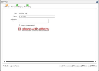

user not able to see share with option in part structure page in view menu user not able to share the view the option share with is not there

    Can you send a screen shot of what you think is missing?
    3-Newcomer
    Jun 30, 2025 5:24 PM UTC
    shared view functionality (1).png   hii please check screenshot where user not able to see share with checkbox

    https://www.ptc.com/en/support/article/CS52962?source=search
    I believe this limited for administrators.
