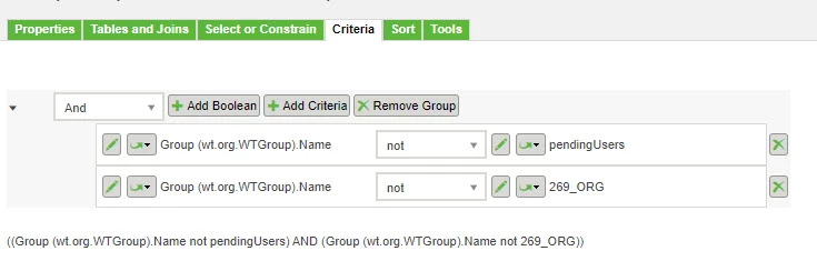

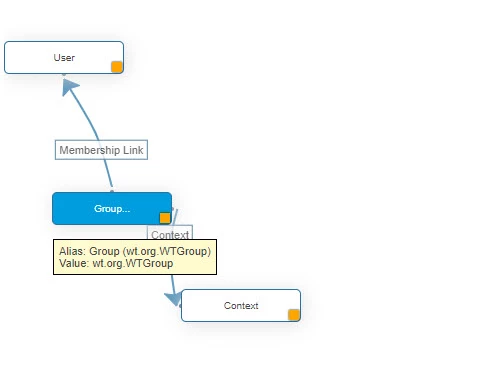

I have a report I created called "User - Role - Context Report". It returns users in all role in all Products/Libraries. It doesn't return any group information though. So, if a person is in a group that is in a role, you won't see that person in the report. I think there was a technical limitation that made this not possible - group information is stored in a different database I think. Screenshots attached. Hope it helps!
Joe
Aug 6, 2020 1:24 PM UTC
RE: group information not being accessible via query builder, this is correct because those are managed through the Windchill LDAP.  It is an inconvenience to not have QB capabilities for that.
For the LDAP point, reference CS45935
