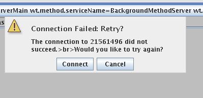

Dec 30, 2014 8:24 AM UTC
PTC document expalins the same procedure.. CS146093..
In our case we were unable to access jconsole via connecting to "wt.method.MethodServerMain wt.method.serviceName=...".
Encountered following error
But its resolved one we straightway used windchill wt.util.jmx.SMJconsole in Windchill shell.
