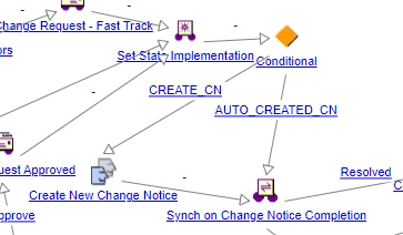

Users forgetting to complete "Create New Change Notice" task
OOTB, the CR only waits on the Change Notice completion if the user acknowledges their creation of the change notice. Functionally, the process continues since the the change notice is created and the user can proceed one. I know its a training issue but the CR workflow is halted until the user completes a task and could impact resolution dates. Do others have this problem and how have you solved it?

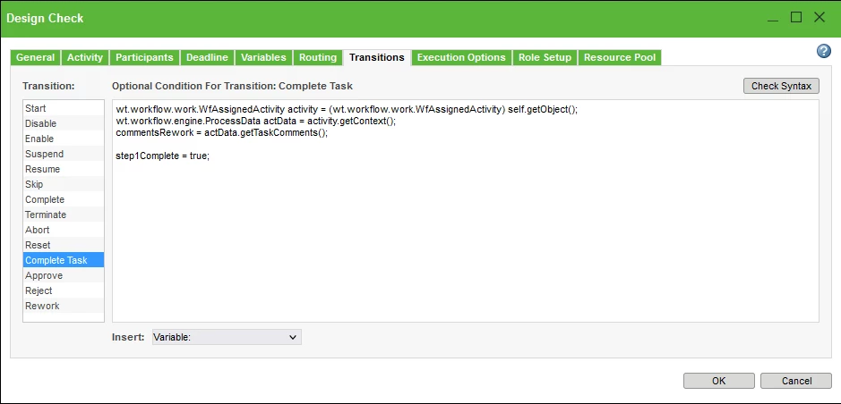

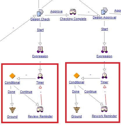

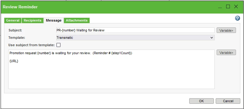

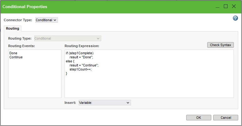

You can also build your own email notification loop.  We have these coming off each task now.
The task transition sets a variable that kills the loop the next time the timer goes off:
As far as modifying the out-of-the-box workflow, I can't imagine not having done that.   We've improved so many things over the years, and I've never had to do anything to it after each upgrade, at least not yet...

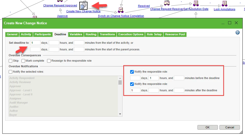

Feb 17, 2023 2:38 PM UTC
If you want to edit or copy the Change Request Workflow, you can set a deadline for the task and add reminder emails. Once the deadline has passed, the task on their Windchill home page will have their Deadline date value show up in a different color (I think it's red). Unfortunately, the max emails without additional customization appears to be 2. Per the help documentation: "Notify the responsible role—You can use these options to specify when the notification should be sent. If you do not specify a date in relation to the deadline, then the notification is sent when the deadline is reached."
The biggest downside to editing/copying a workflow is that whenever you upgrade Windchill you'll have to review if PTC made any changes to the OOTB workflow and manually incorporate the changes. You'll want to have good documentation about what you've customized.
HelesicPetr
Feb 17, 2023 2:50 PM UTC
HI @lhoogeveen
Good advice if the task should be done instantly by user after the task starts.
If responsible user has another work to complete it can takes a week then the task is completed.
There can be just two notification emails to remind the completion.
And I know many users ignore that emails.
PetrH.
18-Opal
Feb 17, 2023 3:12 PM UTC
One solution I have implemented is a loop in the workflow.
The loop includes a timer robot that goes to an email robot which send the reminder email.
Include a conditional robot after the Create New Change Notice robot that will terminate the timer robot.
So, the robot the has a connector to the Create New Change Notice also has a connector to timer robot.
Timer robot goes to email robot and email robot connects (loop link) back to timer robot.
Something like that.
