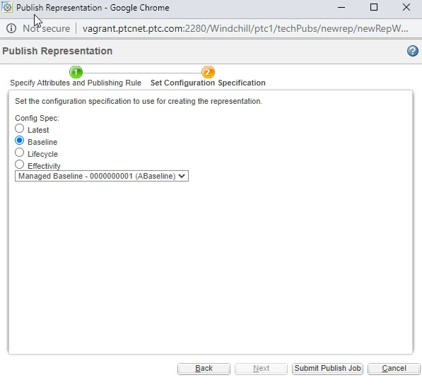

3. You can publish from a baseline.  In the Publish Representation dialog, the second step allows you to select the Configuration Specification.  One of the choices is the baseline.

3. Publishing from a baseline is possible. We use it all the time. However, after editing the filter, the users still have to refresh the browser before the edited filter is actually applied. That additional action (which is sometimes not effective and has to be done a couple of times) leads to mistakes when the user is not very attentive. We are used to it by now, but I want to stress we didn't even know the capability was possible in the first place and when we were pointed to it by a consultant, it was inconsistent at first because we missed the magic of the additional refresh.

I'm not quite sure about your comment about Publishing from a baseline.  For a compound document, you should be able to select the baseline in the second step of the "Create Representation" wizard, and not have to use the filter first.  For a Publication Structure, you can either filter it first or specify the filter a publishing rule.
