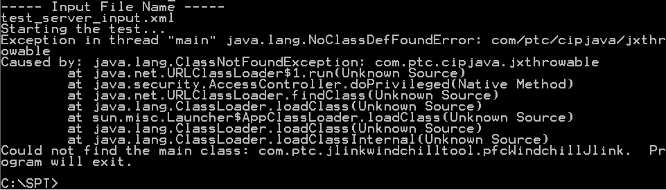

Feb 25, 2016 12:16 PM UTC
Does this work with Creo parametric 2.0? Seems like the libSPT.jar file is only for Creo 3.0.

Feb 25, 2016 5:56 PM UTC
Thanks for the reply. I just realized i might not have jlink installed. Will have to check.

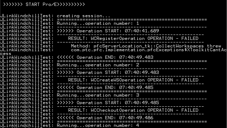

Feb 26, 2016 6:47 AM UTC
Turns out i had to use shortname as the path for proe inside jlink_SPT.bat:
PROE_DIR=C:\Applic\Creo2~1.0\COMMON~1\M090
It now fails on first operation:

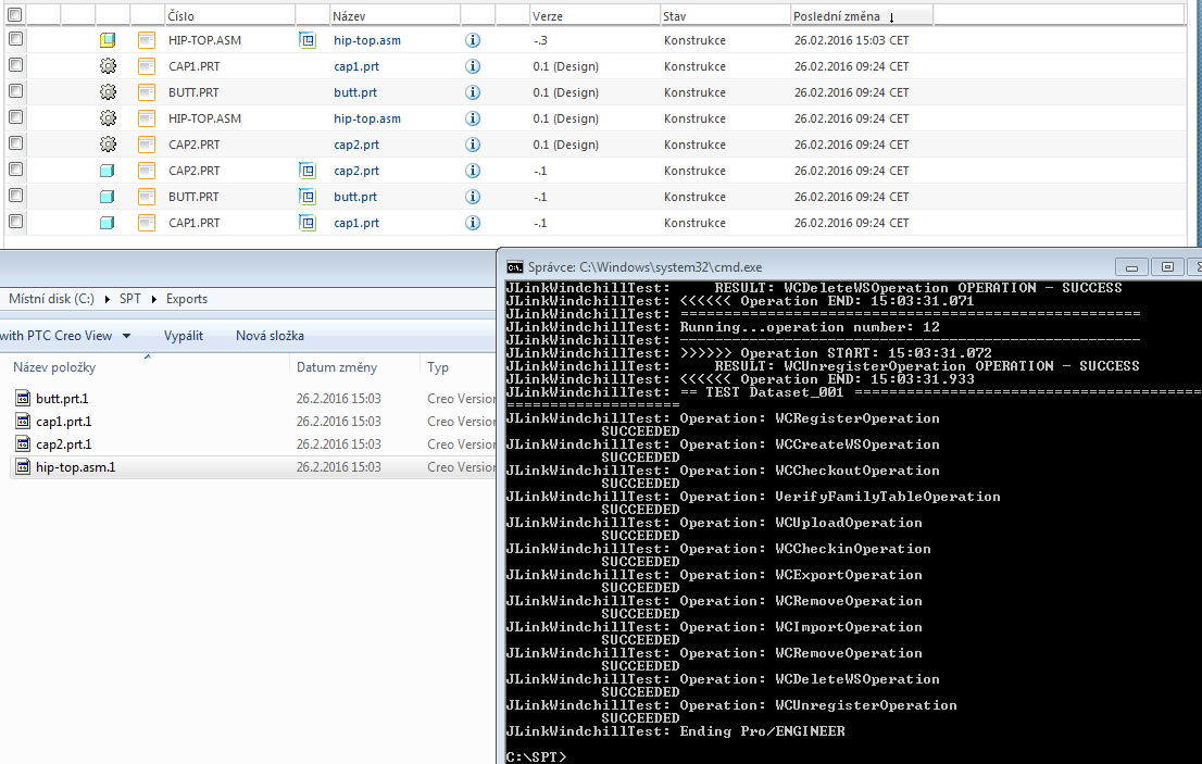

Feb 26, 2016 2:11 PM UTC
Any idea why is it updating only the top level assembly? I've tried to set <Object>Entire Workspace</Object> in the check in file but no go.
22-Sapphire I
Feb 26, 2016 3:52 PM UTC
I could only get it to check out top level also, so we're living w/that.
