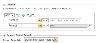

A while back I added these custom WVS Publish actions to my system which appear in the Search Results toolbar:
Windchill PDMLink : An example of customized WVS Job Scheduler Methods...
Recently, I enabled a Thumbnail worker to publish representations on PDF documents. Now, how best to find those PDF document and batch publish them? I could create a custom search looking for "PDF" file format and just click that action but I want something that shows me what's left. Enter the Report Template. I created a report that returns document that have no default representation.
Now, I can run this and select a bunch of documents to publish until they are all done. I do not want to overwhelm the publisher since its day time but I can throw a few hundred every now and then till search comes back zero. Easy.
