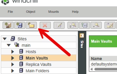

Click the "New Folder" icon. Choose the desired vault (whatever the main vault is called (not defaultuploadvault)

  • Create the logical directory on the computer
  • Site > Utilities > Vault Configuration
  • Create a new folder, and point it to the logical directory created earlier
Article - CS152740 - How to create a new vault folder in Windchill PDMLink
Windchill Vault Configuration
