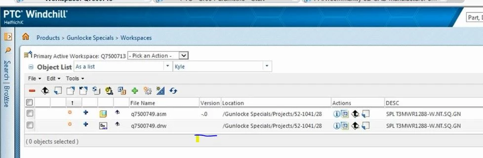

Version not getting updated in Windchill.
Hi All,
When I am trying to upload a drawing it is failing with below error"
A referential integrity violation occurred for this operation:
Object "CAD Document Reference Link - wt.epm.structure.EPMReferenceLink:1752639662" references the object "wt.epm.EPMDocumentMaster:1752639465" that was removed from the system."
Version is not updating in windchil, PFA.
Thanks in advance.
Jun 7, 2017 6:56 PM UTC
Check in the assembly file, then check in the drawing.
Mar 2, 2018 9:11 PM UTC
I am getting a similar problem . I tried checking in the part alone first but still it is throwing the same error.
A referential integrity violation occurred for this operation: Object "CAD Document Reference Link - wt.epm.structure.EPMReferenceLink:9874358477" references the object "wt.epm.EPMDocumentMaster:9874358415" that was removed from the system.
Mar 2, 2018 9:35 PM UTC
Is it a family table part instance?
