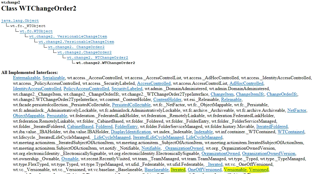

I have a requirement where we want to introduce versioning on CR / CO. I know this is possible since if we look the APIs for these change objects, it has "iterated / Versioned" mentioned. See attached snapshot
hance was just thinking if there is a switch to turn on either versioning / iterations on CR / CO.

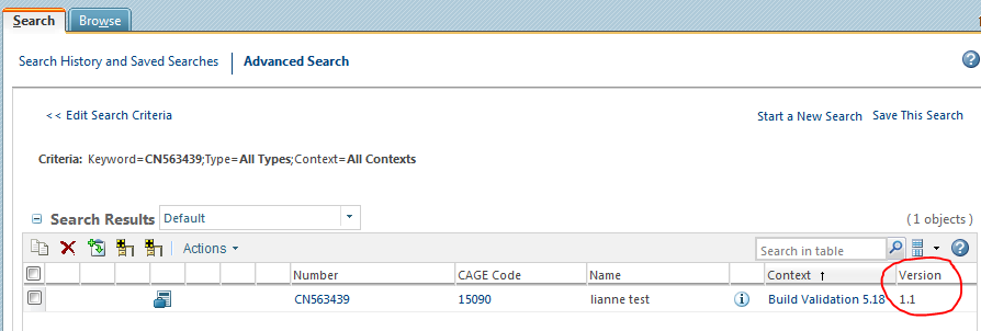

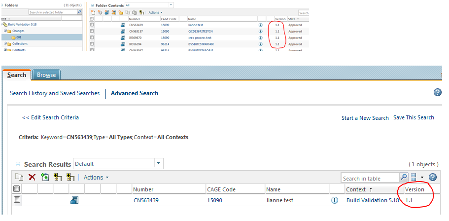

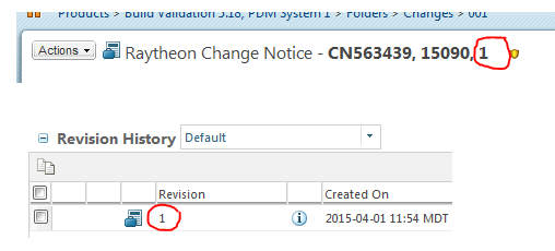

I too was wondering if there could be version/iteration control on CNs/variances.  It is a bit confusing to users where if you searched for a change object or even looked within the product's changes folders, you would see the change object's version (ex, 1.1, 2.1).  Yet within the actual change object there is no iteration. If version/iteration control is not offered on change objects, why do you display it as a Version on searches and folders?

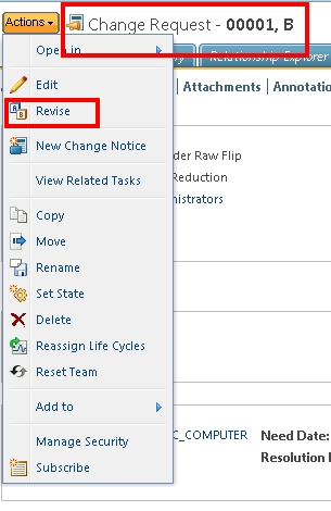

Windchill offers change and revision control on change objects. This feature is controlled by a preference and is  turned off by default. To enable this functionality, set the value of the Change Modification Tracking preference to Yes. This is in Preference Management  > Change Management

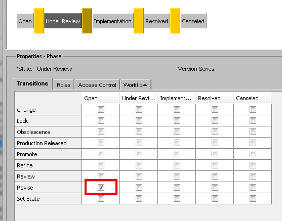

Then you have to enable revise transition in the  corresponding life cycle template.
This will enable revise action in the options
The interesting thing this action will not prompt a confirmation before it actually revises the CR. You click the revise, the revision will change.
To add a prompt follow the steps in https://support.ptc.com/appserver/cs/view/solution.jsp?n=CS159794

Iterations do not display on the actual object but does display when you do searches and within folders.
This is what is confusing to the users.
