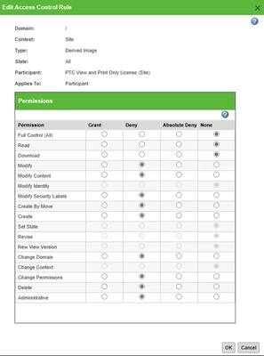

TomU
Jul 2, 2025 10:41 PM UTC
I've seen this before.  I've added an explicit DENY ACL to prevent this from happening.
Similar concept presented here:  https://www.ptc.com/en/support/article/CS412442
